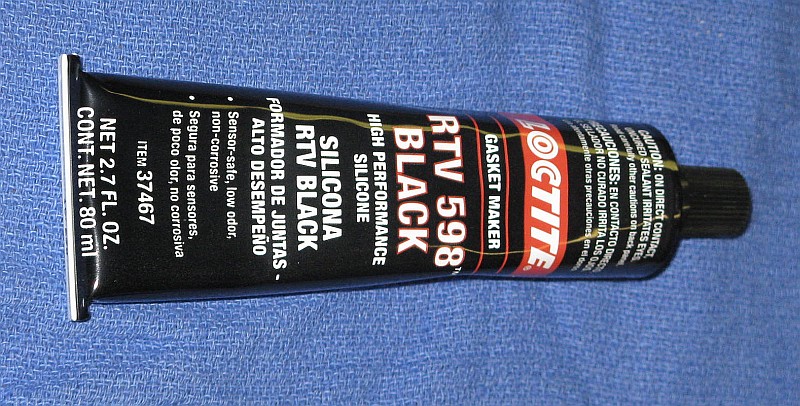

Use an Xacto knife or single-edge razor blade to carefully slice the black
RTV blobs adjacent to the plastic mounts to minimize the possibility of
nicking the heater wire. Pull the tube out and clean off as much of the
residue RTV stuck to the mounts as possible, including what remains in
the holes (since these will be used to inject the glue that secures
the replacement tube). Set the TAJ (with plastic tube mounts installed) aside
for now.

Before starting, identify the locations where the RTV Silicone will be
injected through the holes in the plastic tube mounts. These areas must
have direct glass contact free of any covering - heater wire or tape.
Mark a ~1/4 inch space with a marker for these on the replacement tube.

- Once alignment is optimal, fill the mount injection syringe with
a couple cc of RTV 598 from the tube directly (don't bother with the
plastic nozzle). If the black cap is replaced tightly, the RTV will
remain usable for quite awhile.
Loctite High Performance Black RTV 598 Silicone for Securing Laser Tube
- Inject RTV 598 Silicone through the holes in the plastic Zygo tube
mounts so the resulting blobs are about the same size as the original
ones. Start with 3 holes at approximately 120 degrees and then do the
rest. Not all the holes need to be done on the first round. A half
dozen approximately equally spaced should provide enough strength
once cured so that the rest can be done once the tube has bee removed
from the TAJ. But allow the RTV to fully cure (2 hours) before moving
anything. WARNING: Take care near the anode-end of the tube
to avoid a shocking experience!
Power back up and double check that nothing moved. Allow to cure overnight
(with power off). Trim any excess after curing.
